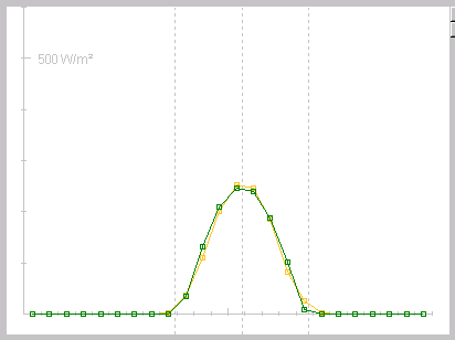

Hi Brigitte,Brigitte wrote:I send you the climate files.
the solar radiation data in the file you sent me are okay; you just entered the geographical longitude where the latitude should be and vice versa. So when WUFI computed the radiation incident on surfaces with different orientations and inclinations for the radiation rose diagram, the solar positions were computed wrong and the resulting diagram was distorted.
The measured data themselves look okay, and they are obviously measured with respect to Central European Time. The following diagram shows one day of your global radiation data (yellow) compared with a theoretical radiation profile for the same date and for a slightly hazy sky (green). The dotted lines mark the times of sunrise, transit and sunset. Evidently the yellow curve complies well with the theoretical expectation; in particular it is not shifted on the time axis.
![Image](http://www.wufi.de/img_wufiforum/CompareSolarRad2.png)
