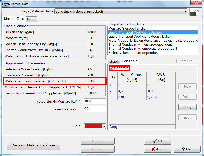

Is a-value (water absorption coefficient) directly accessible in material datas ? I don't find it...
Re: Clinker
The a-value can be used to calculate the transport coefficients. It appears by switching the transport coefficients of suction and redistribution to generate:
The a-value appears in the material data, if generate is chosen for the transport coefficients for suction and/or redistribution. <br />Attention: in Wufi you have to enter the unit seconds not hour (kg/m²s^0.5)
Attention: In Wufi you have to enter the unit with seconds (kg/m²s^0.5) not hour (kg/m²h^0.5).

How to obtain the a-value that for a non-editable material from one of your databases ?
Re: Clinker
You have to unlock the material before, then it will work....
There is something looking like a lock in the upper right corner of the material data window.
