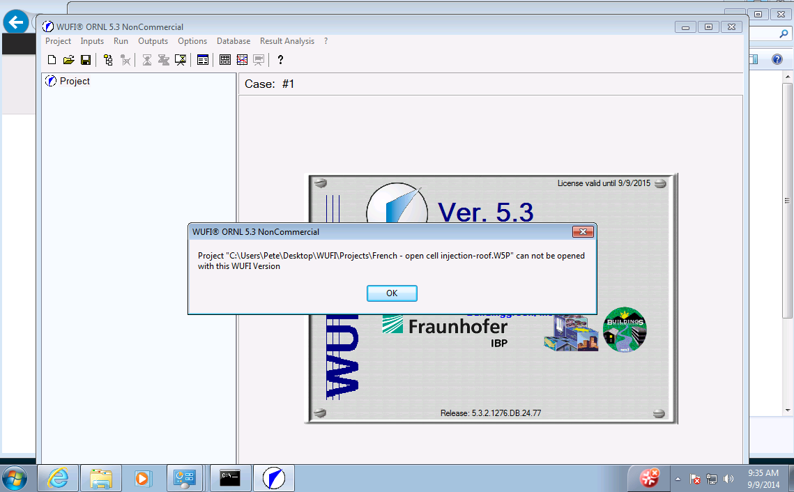

I recently moved my WUFI program to a newer computer, accomplishing this by downloading the most current version of WUFI on my new computer.
I have two files (one for a roof and one for a wall on the same building) created at just about the same time; the wall WUFI file opens fine with 5.3 but the roof file won't open, giving the screen that I have attached as a screenshot.
Any suggestions?
file created under WUFI Pro 5.2 won't open with WUFI 5.3?
- Screen Shot 2014-09-09 at 9.35.33 AM.png (126.89 KiB) Viewed 11917 times

Hello Peter,
Wufi ORNL can not open projects created by Wufi Pro. To gain access to your old projects please reinstall WUFI with your Pro-license. If you do not find it feel free to pm/contact me.

Aaargh -
I was trying to figure out how to install my WUFI Pro 5.2 to a new PC when using my license it is already installed on an older PC, and WUFI support gave me access to WUFI ORNL 5.3 when I asked about doing the re-install of my WUFI Pro.
Can you help with this situation?
