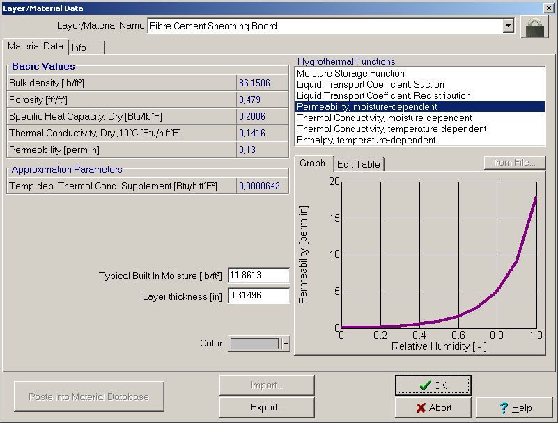

I have been looking for this Water Vapour Diffusion Resistance Factor and cannot find one material with it in the N. American database. Can you please tell me where you see it? I have been trying to figure out how to change it for about an hour. The help file makes it seem like you change it on the Material Data sheet, but I don't see it anywhere.

Hello Lois,
if you´ve set WUFI to IP-units, then it is called Permeability... you can transform the permeability to water vapour resistance, for more information see here:
http://www.wufi-wiki.com/mediawiki/inde ... rDiffusion
In IP-units the water vapour diffusion resistance factor is given as permeability.
