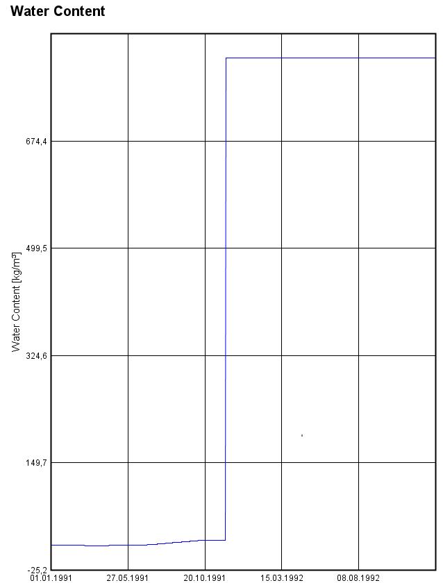

I am currently trying to simulate on a window construction and it has worked fine until i stated a Sd-value of 10 m. All of a sudden the water content went sky high and stayed constant.
Is this do to a convergence error ?

Weird looking water content
- weird water content.JPG (35.39 KiB) Viewed 8995 times

yes, calculation stops due to convergence problems.
This was discussed many times in the forum. See here for example:
http://www.wufi-forum.com/viewtopic.php ... 494&p=1354
http://www.wufi-forum.com/viewtopic.php?f=15&t=332
