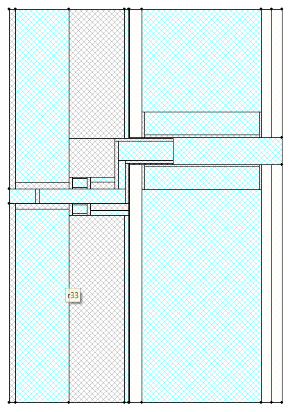

I am having a similar issue. I got an 'out of memory' error when the calculation was 63% complete and I am unable to save the file as all options have greyed out; I have enough RAM memory.
I am analysing a rain-screen construction, some of the elements in the detail are quite narrow. I have the grid set to medium in both x and y directions with maximum number of elements in both directions set at 100. I have attached the detail that I have modelled. I am happy to share the wufi file with you if you are able to have a look at it.
Many thanks,
Sindhu
wufi detail.PNG (32.62 KiB) Viewed 79243 times
