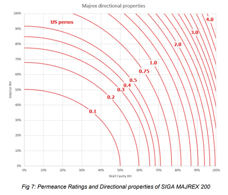

Has anyone attempted to model Siga Majrex 200? If so, how did you approximate its uni-directional/bi-facial moisture dependent permeability? If not, any ideas from the WUFI brain trust on how this might be modeled? See attached permeance curve.

you can contact Siga Customer Service for a WUFI material dataset for the Majrex.
