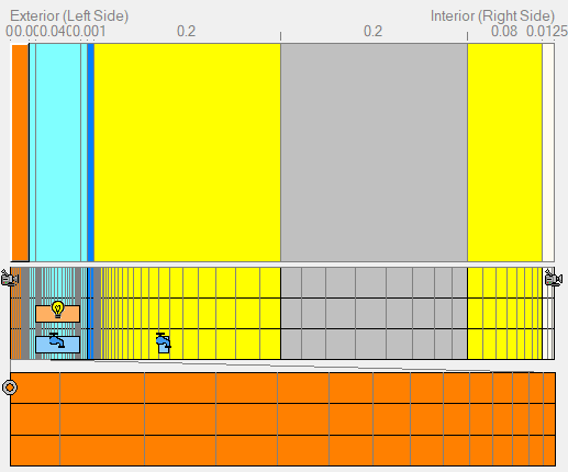

another question;
if I place the rain leakage in the position where we should install the window (see below)
1- when i do a wufi graph, will the values of RH in the window position be realistic? becuase the temperature in the model will be higher (insulation position 1D) instead of exterior temperatures so there is more risk of condensation?
and i do a VTT model for this case i get the next one (see below)
but ,
2-does the model understimate the mould index because the temperatures that choose are higher than in the reality (window frame colder-1D analysis). is it right to do this type of analysis for external layer using VTT and simulation window leakage? (i guees it is more appropiate WUFI 2D for this cases)

1. The rain water leakeage source shall be placed in a material, which can absorb this moisture - behind a cladding or behind an EIFS. In your case normally on top of the WRB. But for sure not in the middle of the EPS which is not absorbing and water tight.
2. If the real temperature is lower, the RH is higher. Of course that influences also the mould risk. However: lower temperature reduces the risk hihger RH increases the risk.
3. If you want to analyze that more in detail you're right: that's more a 2D topic. But like mentioned above: in your case the reain leakage could be deposited on top of the WRB

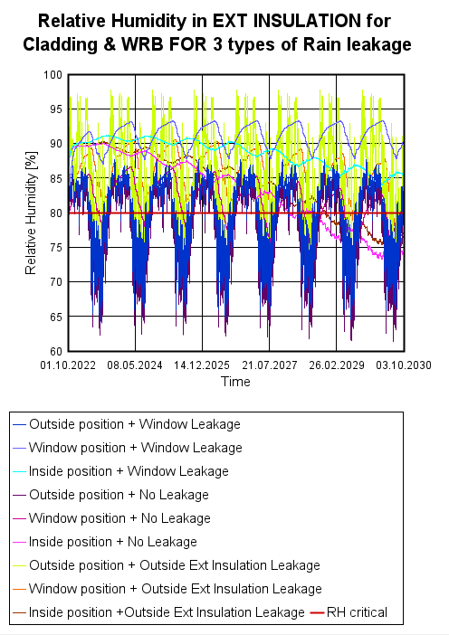

Imagethanks Daniel for your quick answer.
i tried to simulate a window leakage in the sill position to stress out the wall and simulate what can happen in a retrofit house scenario so i wanted to know if it is correct to do like my idea in WUFI PRO (not WUFI 2D that can be more right to do it) and if the results taht i will get can be realistic so i asked about temperatures in that position of he insulation where in reality is the window installed.
let me know please
i placed a leakage in the positio you mentioned
Relative Humidity in EXT INSULATION for Cladding & WRB FOR 3 types of Rain leakage.png
Relative Humidity in EXT INSULATION for Cladding & WRB FOR 3 types of Rain leakage.png (42.89 KiB) Viewed 80562 times
and here you go my results i got, i hope it makes sense them

The WRB should be installed in a way, that rain water from the window sill cannot run behind the WRB bot in front of it. Therefore the source can be deposited in the air on top of the WRB - not in the insulation behind it. That should improve the situation.
