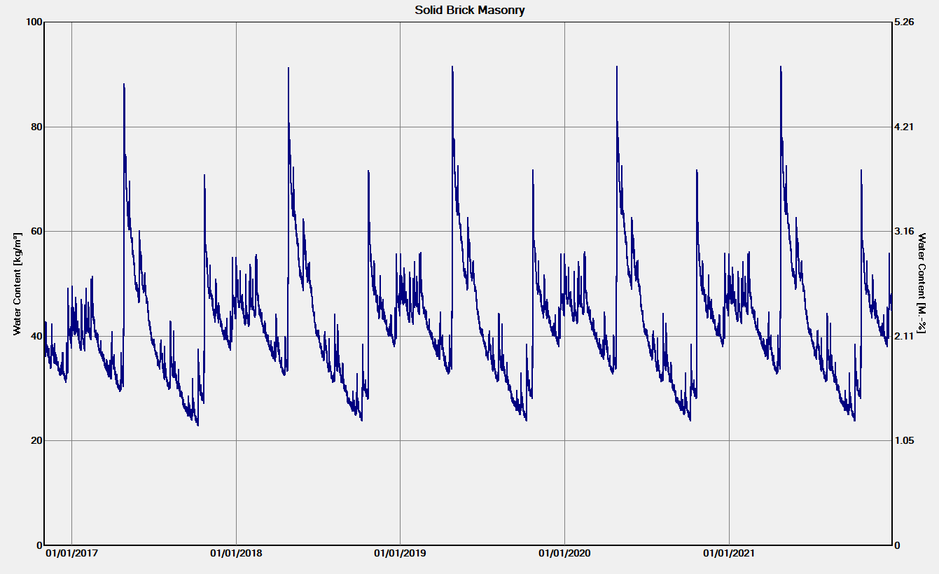

i am modelling a brick masonry with unvetilated cavity and insulated timber frame. The graph of the water content of the brick masonry shows unusual spikes (from 30 to 90 kg/m3) in a very short time and at regular intervals which would be very little justifiable by the climate only. I am using a watehr file generated with Meteonorm. Can you please let me know if this is a common outcome and if not how to correct this anomaly?
brick graph .png (20.63 KiB) Viewed 53966 times

the spikes are related to rain events. That is the typical behavior of a brick masonry with a high a-value.
Have a look in the film (Animation 1D or WUFIMotion2D). There you can see how the water gets distributed when a rain event occurs.
