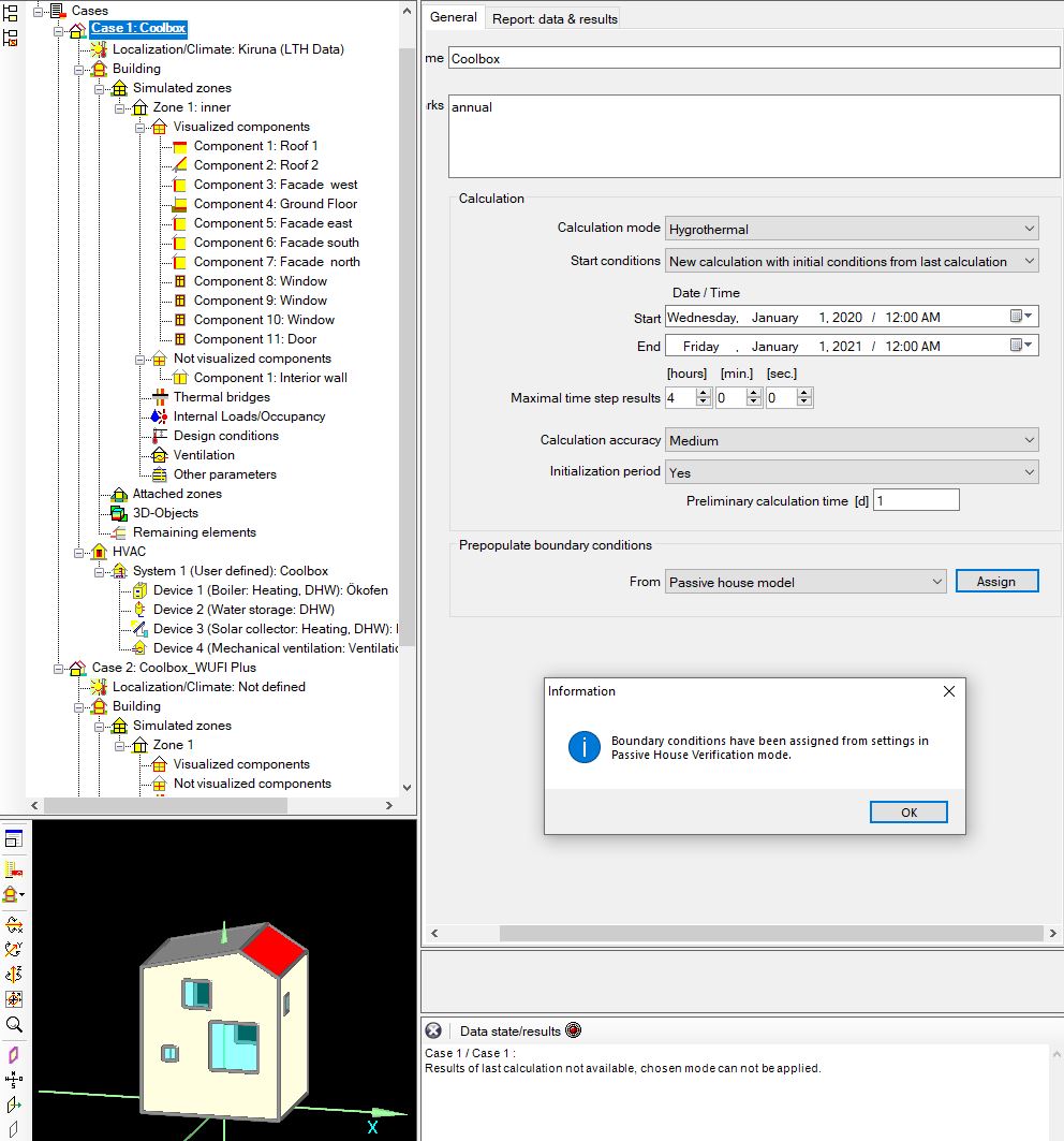

I finished the (scope) Passive House Verification (not fulfilled the Passive House criteria). I would like to make the dynamic hygrothermal simulation WUFI Plus.
I saved the project data as a new project and I chose the scope: WUFI plus.
I tried to prepopulate boundary conditions from the Passive House model, but I got the following message: (Boundary conditions have been assigned from settings on Passive House Verification mode.)
How can I transfer the parts of the building?
- Boundary conditions have been assigned from settings on Passive House Verification mode_2020 05 19.JPG (161.56 KiB) Viewed 80086 times
