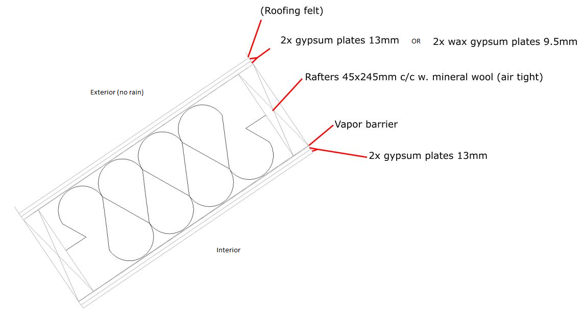

I want to simulate the a roof with roofing felt as DensElement™ BARRIER SYSTEM from wufi database.

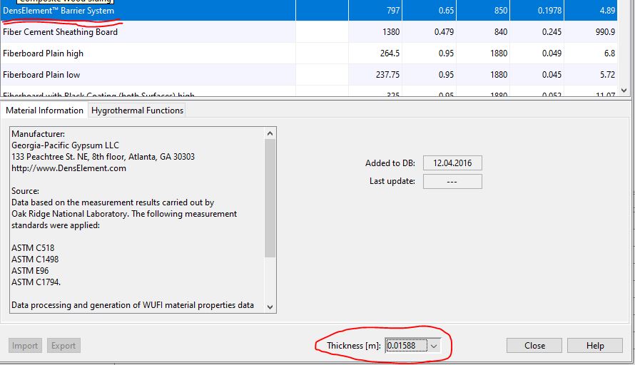

  2. As seen in the figure below the thickness of the den-element should be 0.01588m. If I want to include the dens in my simulation is it neccessary to adjust the thickness of the dens element to 0.01588m?

i. I want to simulate a roofing felt. The roofing felt should be open. That is, vapour can pass out of the construction but liquid will not pass through it into the construction. Is this doable in WUFI?

2. in the material data base of denselement there is window down below that says thickness 0.01588m (see figure above, red circle) Does this mean that the dens-element I create in my construction in WUFI should be 0.01588m?

2. If you mean "Vapor Transport Coefficient" then the my value = sd value [m] / Thickness [m]. The sd value is roughly 200 ng/smPa / 1823 ng/sm2Pa =0.11m.
