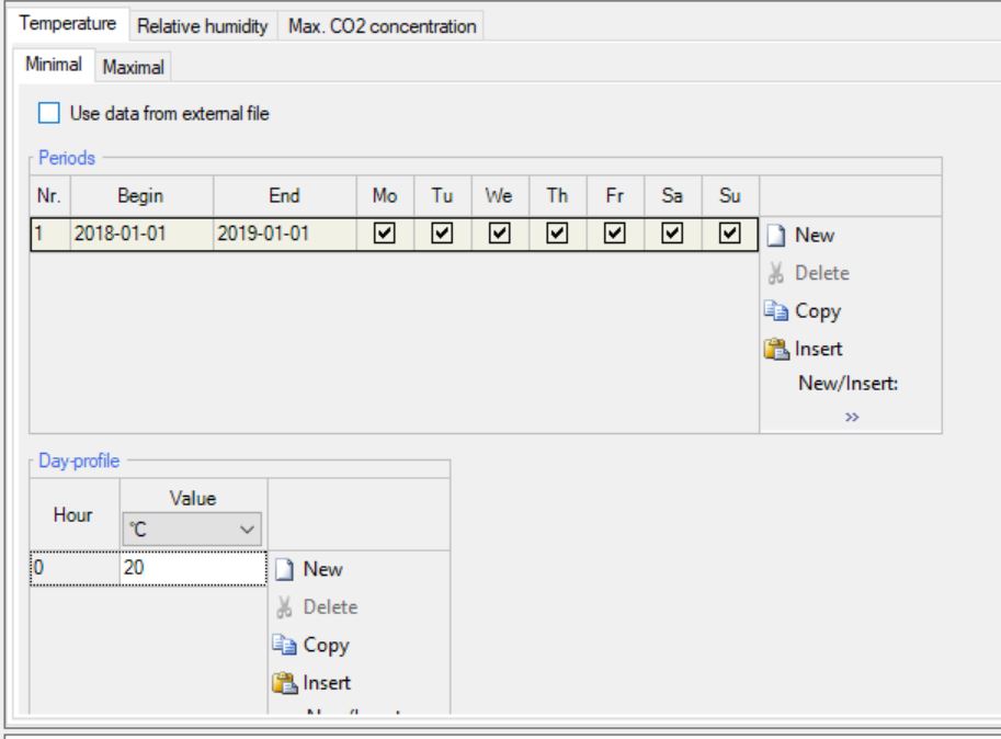

What I mentioned is this interface, do we have a sample for attic ventilation

Re: Import Field Measurement Weather Data to Attic Area
you might can regard the attic as attached zone with pre-defined climate conditions.
At first you can define the 'extern climate data' file structur ( in the Project tree: 'Fiels/Measured data'). Then you can define this file as optional climate data and then use this optional climate data for the attached zone.
Most of it is shown in this movie:
https://www.wufi-wiki.com/wufifilme/Plu ... d_Data.mp4
