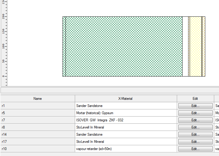

Thanks for your reply. I modified the convergence criterion to 1e-6 and on the other hand, the mesh I had was the same in the 2D simulation and the 1D simulation. In addition, for this case and to make the simulation faster, I simplified the model not including the wooden beam detail (I attach the detail of the simplified model 2d).
Despite the modifications, the results in the simulation are still the same as those obtained previously. I can´t get 2D values close to those obtained in 1D simulation. What can be the reason for this difference?

- Layers from the outside to the inside
1 Sandstone (1+39 cm)
2 Gypsum (2 cm)
3 Mineral revoque (0.5cm)
4 Glasswool (4cm)
5 Vapour retarder (0.1cm)
6 Mineral revoque (1cm) - WUFI2D (1).PNG (22.93 KiB) Viewed 13727 times

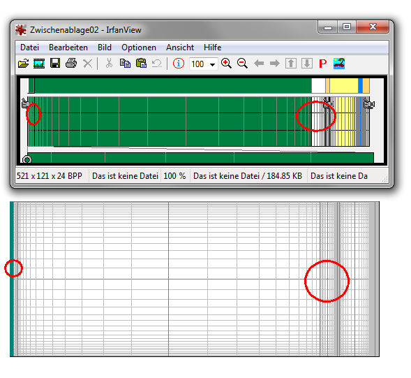

the grid is still quite different between both your cases: Furtehr please go to Computational Parameters -> Advanced Settings and change the values for NSW from 4 to 1000. Thats the iterations for the inner solver loop. Sometimes 4 is to less. 1000 allows to use more iterations, if needed.
