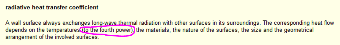

I have a question about radiative heat transfer coefficient.
The photo as follow is a screen shoot in Help, I cannot understand what's the meaning of "the fourth of power".
Could you please explain this principle.
Thank you very much!
Radiative coefficient.PNG (39.76 KiB) Viewed 8172 times

It is the number 4 in the exponent. Just research Stefan-Boltzmann-Law
