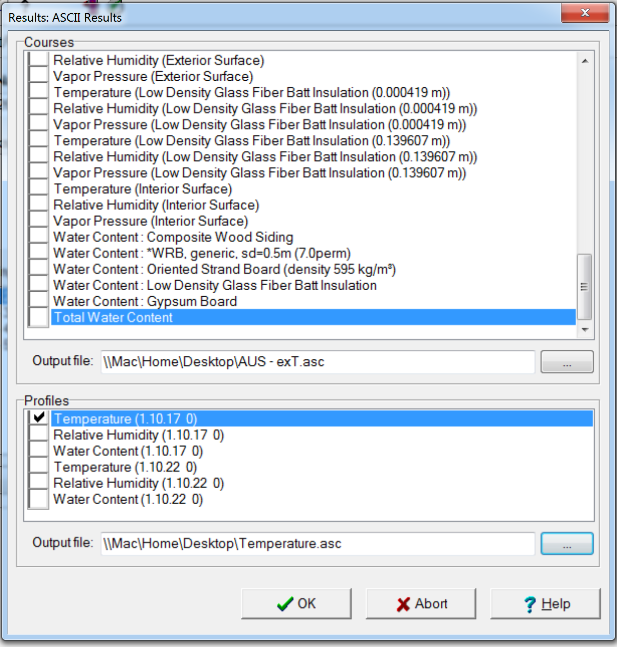

Re: Water content of assebly layers: importing values from file
You have to export the temperature and water content profiles in two separate files, otherwise WUFI will not read it.

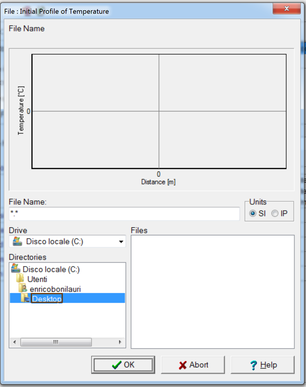

I still have some trouble. I think I'm exporting the ASCII files correctly, but when I try to import them as initial conditions WUFI doesn't "see" them.
Please find attached a couple of screenshots, and the ASCII file I exported and I'm trying to import.
Am I missing anything?
Thank you!
there may be an issue, if the file extension is not shown in windows. Please try to copy the full file name in the file name field.
Make sure, the file exists.
Hello Christian,
For some reason, this window of WUFI does not read my desktop folder (to be fair, it's the desktop of the host Mac, while I'm running WUFI on a virtual Window machine with Parallels).
It reads other folders, and if I move the .asc files there, WUFI reads them correctly.
Thank you,
Enrico
Thank you,
Enrico
