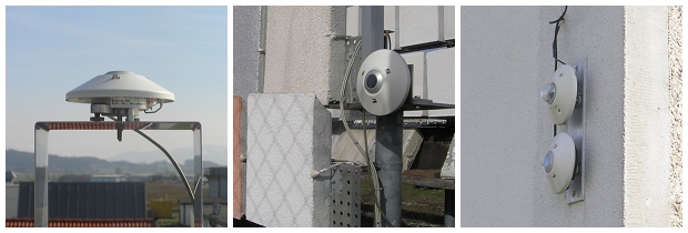

Posts: 421
Gunes Inan wrote:The only thing that I need to do, as I understand, is to locate the radiation sensor vertically at nights, so as to obtain the radiation data corresponding to the sum of atmospheric counterradiation and terrestrial counterradiation.
The reason I am asking this is that meteorological systems manufacturer, at least the ones I am in contact with, are not quite familiar with term like atmospheric counterradiation, and I need to figure out exactly what I need before I built my system.
Hi Günes,
we are measuring the long-wave counterradiation with pyrgeometers. The attached picture shows one of them oriented horizontally for measuring the atmospheric counterradiation and two others oriented vertically for measuring the counterradiation (atmospheric and terrestrial) incident on the respective building components under investigation. In the third case, there is also a pyrheliometer (or solarimeter) for directly measuring the solar radiation incident on the facade. And of course they stay in these positions by day and by night because if you wish to explicitly take counterradiation into account for the energy balance at the facade, you must do so by day as well as by night.
I hope this helps. If you wish to use your measurements for WUFI calculations, please contact us about how to create climate files from the measurements. This can be a somewhat complex issue and it might be difficult to figure it out for yourself.
