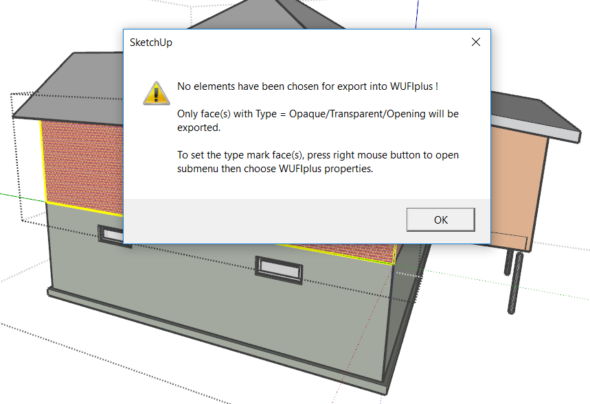

Hi, This is more of a sketchup question but hoping someone can help me. I'm using sketchup with a model that was originally built in archicad to export into wufi passive. I can select and label the faces but when I try to save or export the geometry I get an error message that none of the elements have been selected. I have another model that is much simpler that works but for some reason with this model even though when I right click on the faces I can confirm that the wufiplus properties are properly identified, however, when I try to save or export sketchup says there are no elements selected. Thanks for your assistance.

I suggest creating much more simplified geometry freshly in SketchUp. To save time, perhaps use imported ArchiCad geometry as a base group to build over then delete it from model when done. I've successfully followed this workflow a number of times with Revit.
