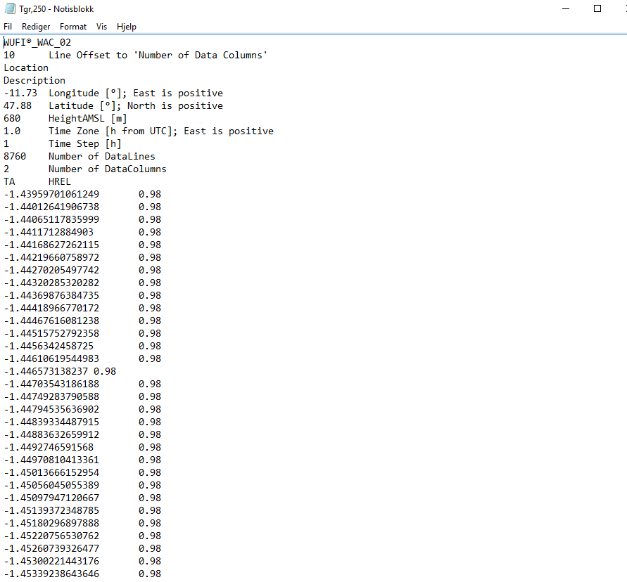

2017-03-28 16_31_15-Tgr,250 - Notisblokk.png (34.94 KiB) Viewed 8528 times
I've created climate files for a construction against terrain. I've used the document "createclimatefile" in exel and converted it to a wac-file. The files looks good when i import them into WUFI. It also works running simulations, but there are no changes in any parameters. So temp, humidiry, water content .... in the construction are constant. The simulation works if i use a climate file which follows the program, so there is no problem with the model.
So i was wondering if can check out the climate file which is attached, and see if there is any errors.
Best regards, Sondre Lund

Likely your transfer coefficients are zero
