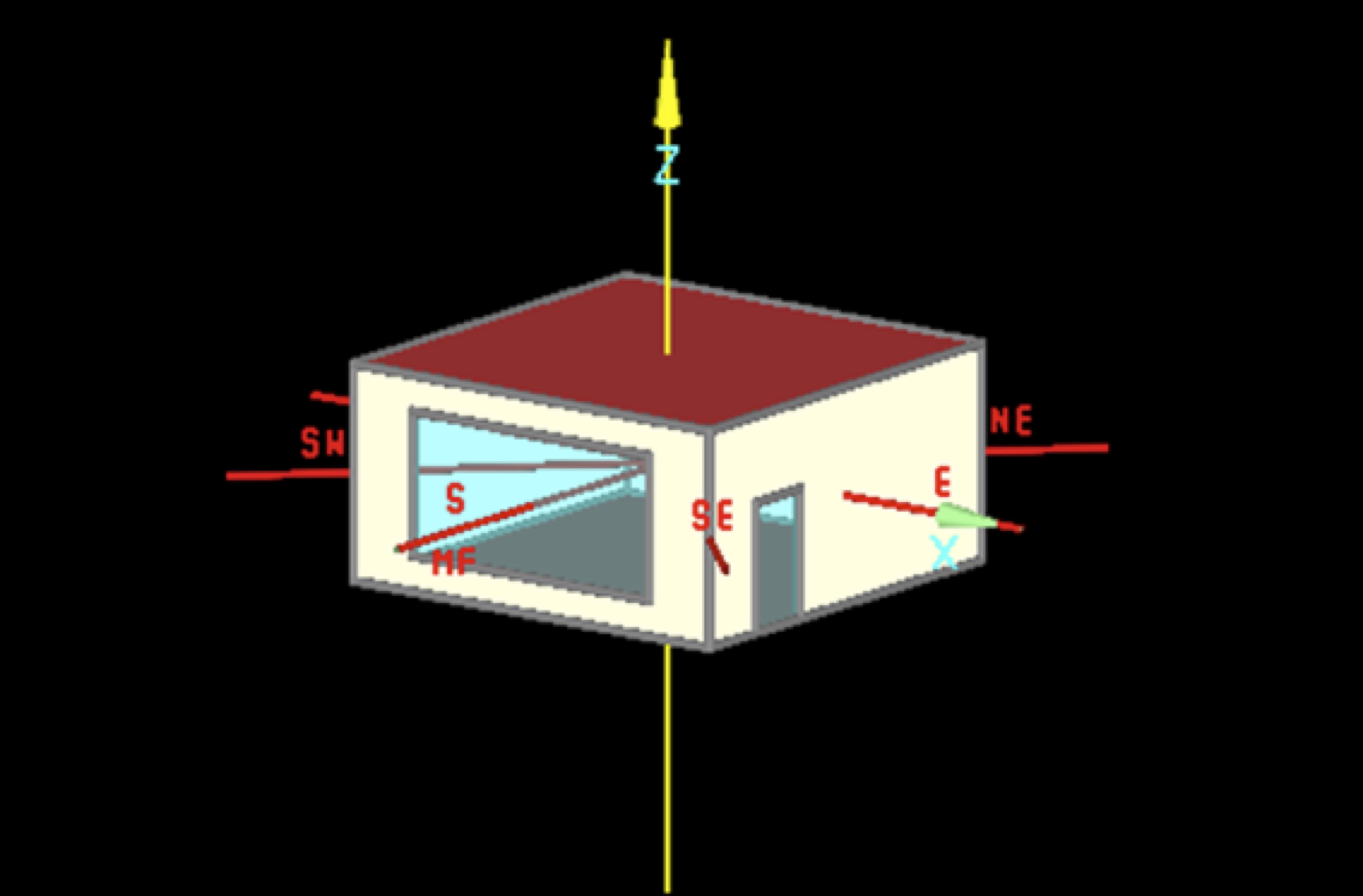

In order to apply Plus 3.0.3 for evaluating hygrothermal performances of timber framed detached house, we ran a simple benchmark case. It consists of a single zone of 6 x 6 x 3 m with windows of 4 x 2 and 4 x 1 m.
In the graphical results of heat flow (monthly), the monthly heat flow on the opaque elements seems to be unacceptable since it shows the gain through the whole year.
Please explain the reason why it shows a heat gain in the severe winter period.
The average insulation level is specified to the opaque envelope.
We would suspect that it might absorb unreasonable solar radiation on the exterior surface.
* Please notice that the attached input file and the result was in Sendai not in Tokyo.
If we switched the city from Sendai to Tokyo, the result would become the more unacceptable.
Thank you in advance for your cooperation and answer.

- The geometry of a benchmark hut
- Geometry_of_Benchmark_Hut_6x6x3.jpg (415.87 KiB) Viewed 8707 times
