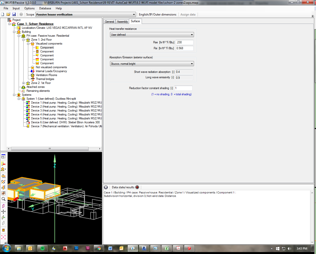

I'm hoping someone can help me. I'm very close to getting some output from my WUFI Passive file, but i get an error that reads: "...Visualized components/ Component 1: Subdivision horizontal, division 3, not valid data: Distance."
I'm at a loss as to what is causing this error. I've included a screenshot. Any help is appreciated.

Ok, if you click on the Error message the software jumps in the "Surface" Tab of the component with the error. This will be fixed for the next release. It should jump in the "Assembly" Tab.
But the text of the Error message should be correct. So go in the Assembly Tab for component 1 and edit the assigned assembly. Check the Subdivion Horizonal for each Material / Layer. I guess there is a zero or no entry for one Layer.
