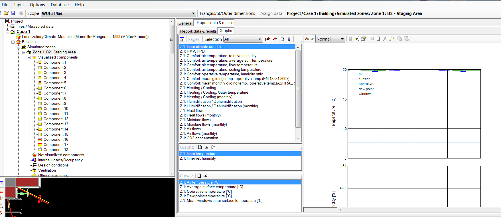

I Guess I have a problem with the "Data and result" menu because I haven't got the "export" tab (like in the joined capture file).
I would like to export results to Excel but without this tab, I can't...

the export Tab is only available for the Project treenote: "Case" -> Report and Results, and for the Component Results if you check retain the calculation results before the simulation.
