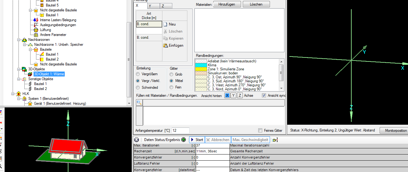

wie funktioniert die Darstellung von Objekten in 3D bei WUFI Plus V2.5.4.0?
Danke im Voraus!

zuerst sollte die "Einteilung" in x-,y- und z- Richtung angepasst werden, dann können Materialien (vorher hinzufügen) und Randbedinungen den entsprechenden Schichten zugeornet werden.
Es gibt einen Film im WUFI-wiki, der dies erklärt:
http://www.wufi-wiki.com/wufifilme/movi ... bjects.htm
Viel Erfolg!

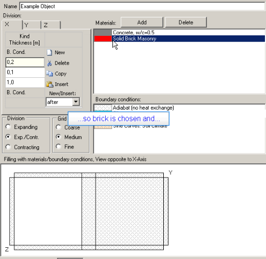

above is the example interface in the guide movie.

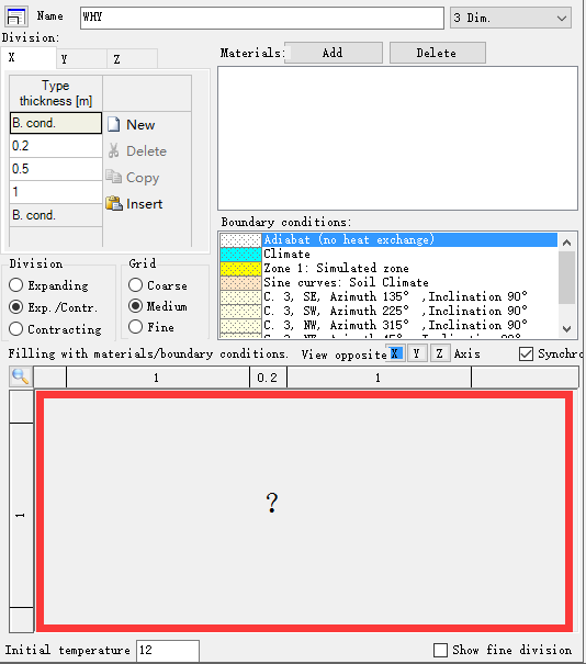

below is the interface on my screen when defining a 3D-objects.
after inputing the thickness divisions in x,y,z, there are on division lines showed up in the blank box. so the material cannot be assigned to specifical region.
how could be such wrong? is there any steps should be carefully handle when doing with 3D objects?

ok ok!!!
I FOUND THE MATTER.
when inputing the thickness, such as 0.5M, the decimal point should be inputed as the comma.
Posts: 202
Re: 3D Objecte
Post by mpazold »
ok. normally both, the comma and the dot should be possible...
however, below the 3D-visulalization for the 3d-object, there should be the "Status:"-message for the object givin you the hint, where the error occur.
