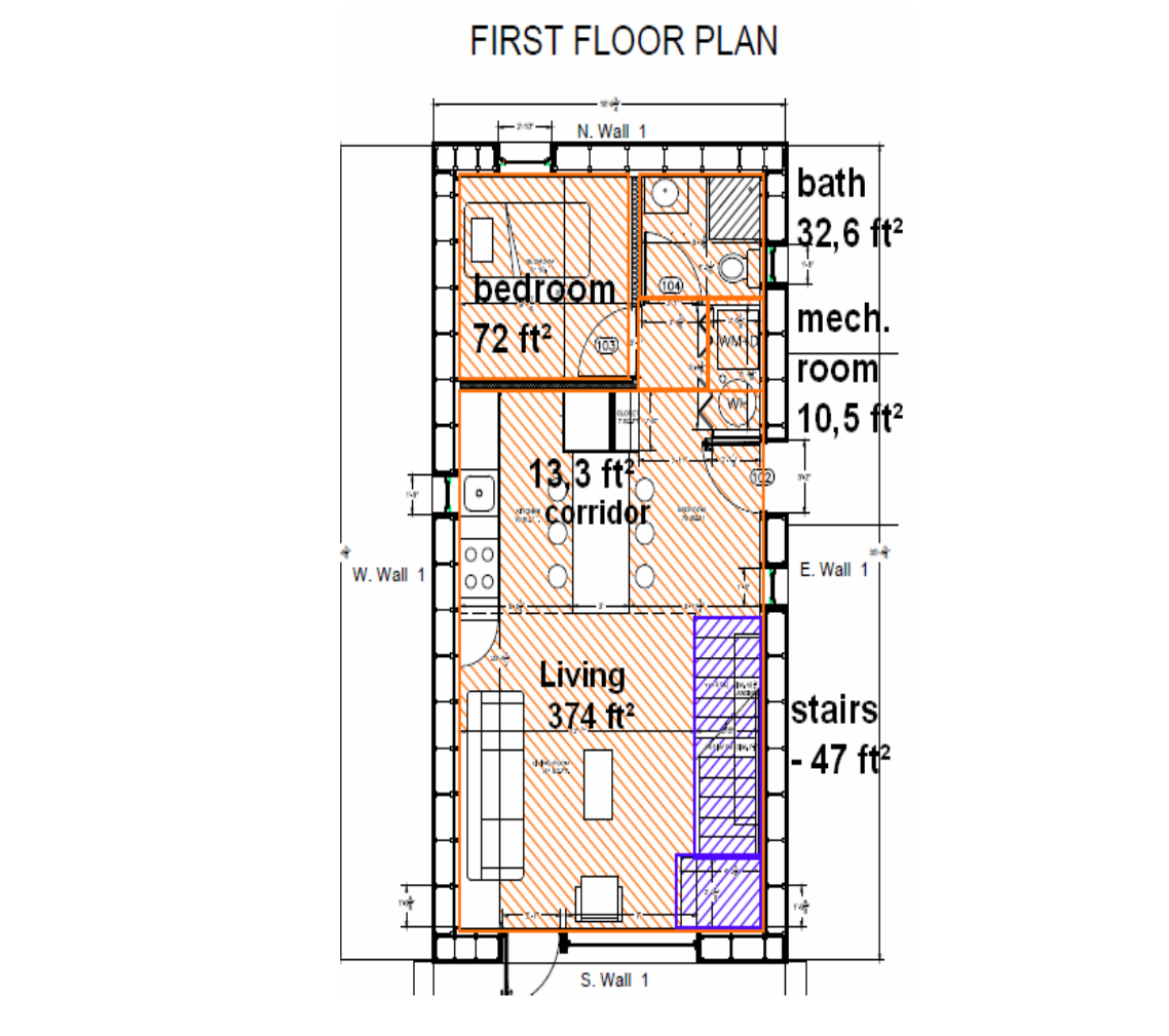

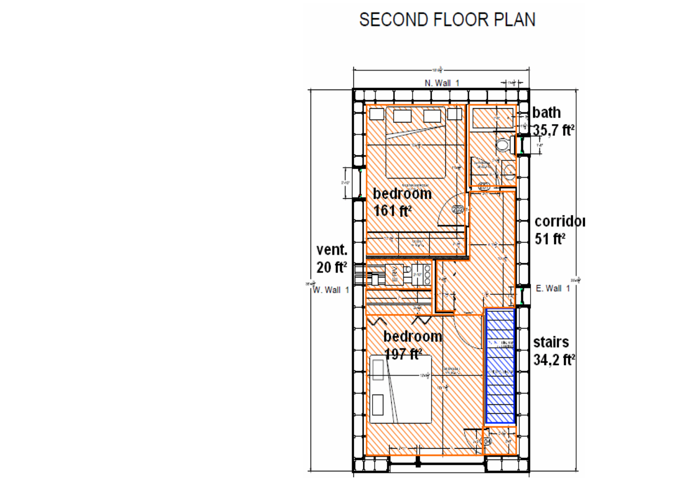

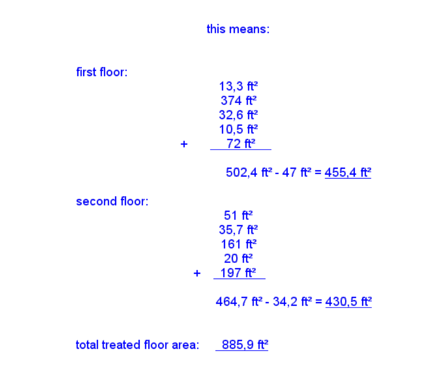

I think I found a calculation error in the Treated Floor Area Movie. See the attached screenshots. It looks like the stairs were not included in the total for first floor area and second floor area, and in addition the area for the stairs was also subtracted from each floor. So the stair area was in effect subtracted twice. Am I looking at this wrong? Just want to make sure I understand the calculation method. Also, I am assuming the area of the walls is not included in the TFA calculation. Is that correct?
Thanks,
-Russ
