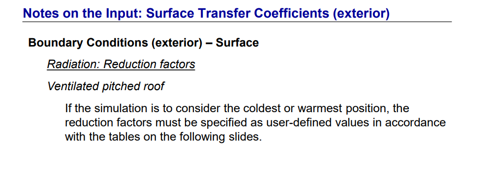

thanks for the reply, but, is it correct to follow "Guideline for the Calculation and Evaluation of an ETICS with Wood Fibre Insulation" for the build-up assembly that I have?

The picture is from the pitched roof guideline an not related to your ETICS?
