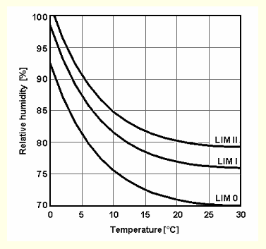

Could you please provide me the experssion of the LiMs curves? I want to reproduce the curves using Excel.
LIMs experssion
LIMs experssion
- WeChat Image_20220705175850.png (14.55 KiB) Viewed 60879 times

Hi WEI LI,
the LIM curves are described by the hyperbolic cosine function as follows:
\(\varphi_\mathrm{lim} = \frac{\cosh(a \cdot (b-x)) + c}{100}\)
(where \(\varphi_\mathrm{lim}\) is expressed as a fraction \(0 ... 1\))
with the constants
Keywords: WUFIBio, LIM, LIMs, isopleth, isopleths, germination, growth
with the constants
Code: Select all
LIM 0: a = 0.128324 b = 30 c = 69
LIM I: a = 0.128324 b = 30 c = 75
LIM II: a = 0.128324 b = 30 c = 78.29

Thanks for your reply.
Is it from Sedlbauer, K. (2001). Vorhersage von Schimmelpilzbildung auf und in Bauteilen: Lehrstuhl fur Bauphysik.?
Re: LIMs experssion
Yes, the procedure used by WUFI-Bio is based on this thesis. But I think the mathematical function and the numerical values quoted above have been adopted for the numerical implementation in WUFI-Bio, you won't find them in the thesis.WEI LI wrote: Tue Jul 05, 2022 2:10 pm -1100 Is it from Sedlbauer, K. (2001). Vorhersage von Schimmelpilzbildung auf und in Bauteilen: Lehrstuhl fur Bauphysik.?
