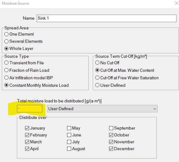

I want to model a cavity drain to see the impact that a moisture sink has.
Reading around it looks like I need to enter a Moisture Source with a negative value. However this does not seem possible.
I was expecting to be able to enter in the box in the screenshot below but this doesn't work. Can you help please?
Screenshot 2021-05-18 194753.jpg (59.04 KiB) Viewed 85343 times

Hi David,
the monthly moisture loads are meant to be a challenge for the drying potential of the building component and therefore accept only positive source strengths.
To define a moisture source with negative source strength, please use the option "Transient from File". The help file explains the format of a user-provided source strength file.
