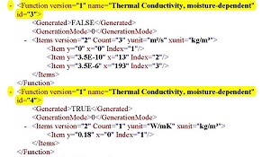

Function id 3: should the name be “Liquid transport coefficient, redistribution”?
The name “Thermal conductivity moisture dependent” is used for both function id 3 and id 4.
In the XML file I just exported from WUFI 6.3 to check this, id 3 has this name, and I can't see any problem with the names for the thermal conductivities. Maybe you saw this in an older version of WUFI and these have been fixed now.

Hi Thomas,
Many thanks for your detailed and clear answers.
With regards to the least important point: 'XML function names for ids 3 and id 4.' I am using WUFI Pro 6.3.
I've included an xml extract for: 'fired clay brick used for cellars ' to illustrate the duplicate use of the name "Thermal Conductivity, moisture-dependent" that I am seeing.
Peter
Posts: 430
Re: XML material data queries: Drying factor, thermal conductivity and water content
Ah, I see. Thanks, I have alerted the programmers to look into this issue...
