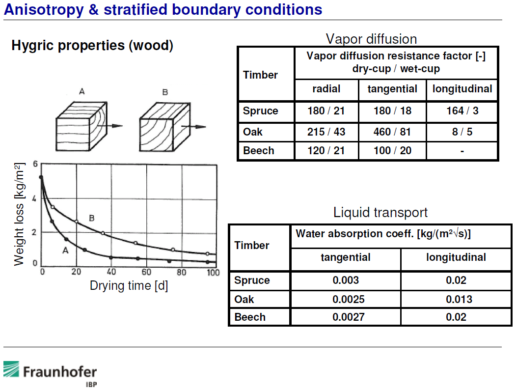

That depends on your construction and materials.
The transport coefficients for wooden materials will be different in radial/longitudinal direction e.g.
WUFI2D overtakes density/porosity/heat capacity/moisture storage function from the defined x-material.

Properties in the x-direction is not more important than in y-direction and vice versa. You can set different properties in the two directions because not all materials have same abilities in all directions.
When it has same abilities in all directions it´s called Isotropic material
When it has different abilities in different directions it´s called anisotropic material
ex. mineralwool don´t have the same thermal conduction in x and y direction due to orientations of the fibers.

Some materials show anisotropy for heat conduction, vapour diffusion and liquid transport at least.
More about in our WUFI2D-workshops :)

Yes, that makes no sense to use mineral wool in one direction and EPS in the other, but you got it.
If you don´t have any information (measured values) about the anisotropic behavior of a material use same properties in both directions.
