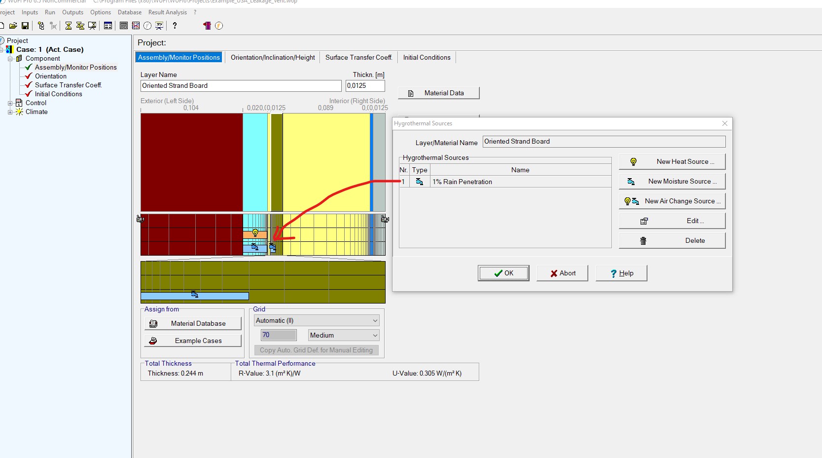

3- in which situations (for ventilated and unventilated air cavities) do we have to introduce a heat sources? What fraction of the heat source do you put according to the material in front of the air cavity? for brick, will it be no heat source?
4- would it be ok to model it as I have done since the one on the left is a moisture source from rain (1%) and the one on the right comes from the Air infiltration of the interior (where humidity can condense) (5 mm of thickness each of the moisture sources)? (for ventilated and unventilated air cavities) (see image below)
IMAGE 1.jpg (108.23 KiB) Viewed 67793 times

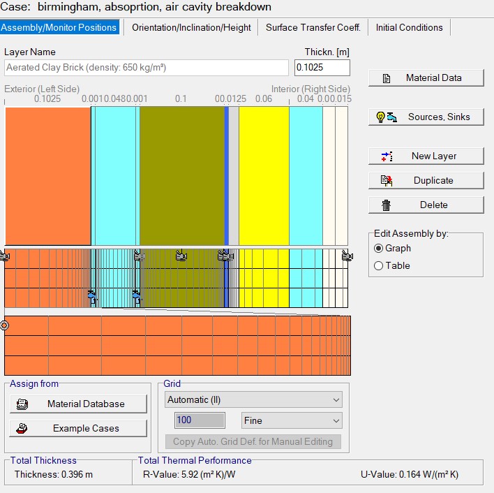

5- for unventilated and unventilated air cavities, is it more advisable to model it following way (1 mm - 48 mm - 1mm = 50 mm) (see image below)? (where the rain source will be the left film layer of 1 mm and the infiltration air leakage the right film layer of 1 mm). I found in WUFI FORUM where the 1 mm air film layers are with additional moisture capacity (the middle one is without additional moisture capacity) (see image below)?
IMAGE 2.jpg (111.46 KiB) Viewed 67793 times

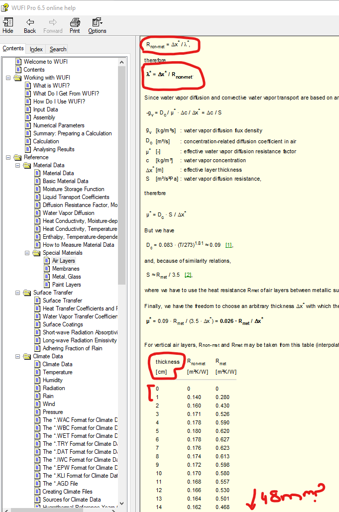

6- would the properties to change of each layer of air (air layer) be only those of Basic Material Data or also those of hydrothermal functions? since in the WUFI database there are no 1mm and 48mm layers.
7- How do you calculate the thermal conductivity of a 1 mm air layer? because the interpolation is not possible since it comes out linearly from the value 0 to 1 cm.
The 48mm would be between the 50mm and 40mm air layer?

Usually we put thin “normal” air layers (1 mm) on the boundaries and put those “without additional moisture capacity” in the middle. All three layers together should result in the desired total thickness. If you do so, you can evaluate the water content.
But please keep in mind to set all the air layers with the material name of the desired total thickness. Otherwise the effective parameters for convection and radiation are not right anymore. For example, if you like to simulate a 30 mm air gap the construction is the following:
Air Layer 30 mm 0.001 m
Air Layer 30 mm; without additional moisture capacity 0.028 m

6. I guess the questions 6 and 7 are also answered with point 1) because no air layers with the thickness of 1 or 48 mm are needed.

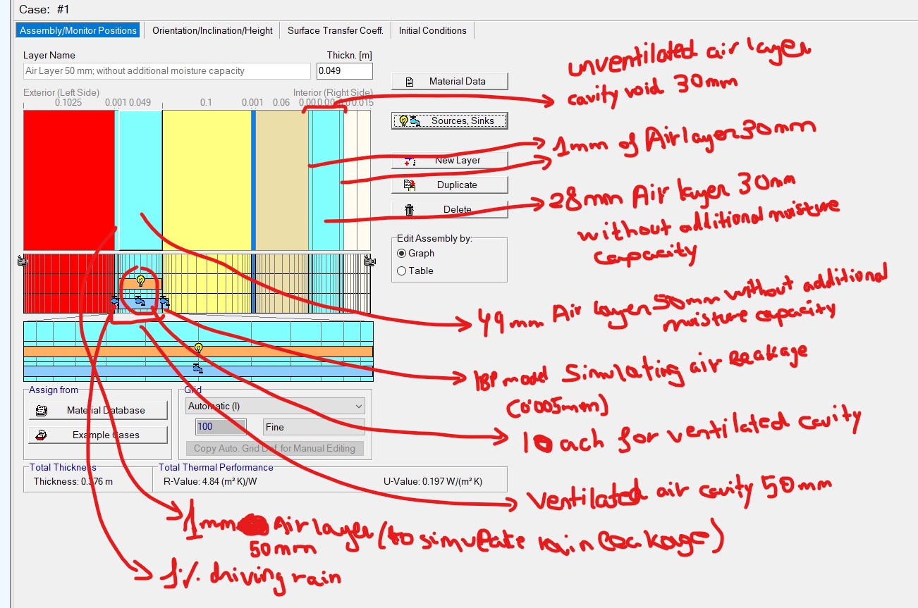

thanks for the answer but I do not know if I understood some part of it
1- I attached an image to clarify what I need to know when I modelled an unventilated and ventilated air layer
Are my comments right?
2- How would I model the outermost air layer if it is an unventilated cavity instead of ventilated cavity?

I´m not sure what you didn’t understand, so I try to clarify.
Starting from the exterior side of the construction, the assembly can be look like this:
- Brick wall (or other masonry) 0.1025 m
- Air Layer 50 mm 0.001 m Here you set the 1% driving rain source
- Air Layer 50 mm, without additional moisture capacity 0.048 m Here you can set your ACH for a ventilated cavity
- Insulation Material 0.1 m The IBP Model source can be set in the outermost 5 mm of the insulation layer
- Air Barrier / VCL 0.001 m
- Unknown material 0.06 m
- Air Layer 30 mm 0.03 m (One layer is enough! See post above)
- Gypsum board 0.0125 m
- Gypsum Board 0.0125 m
Hope this helps you!

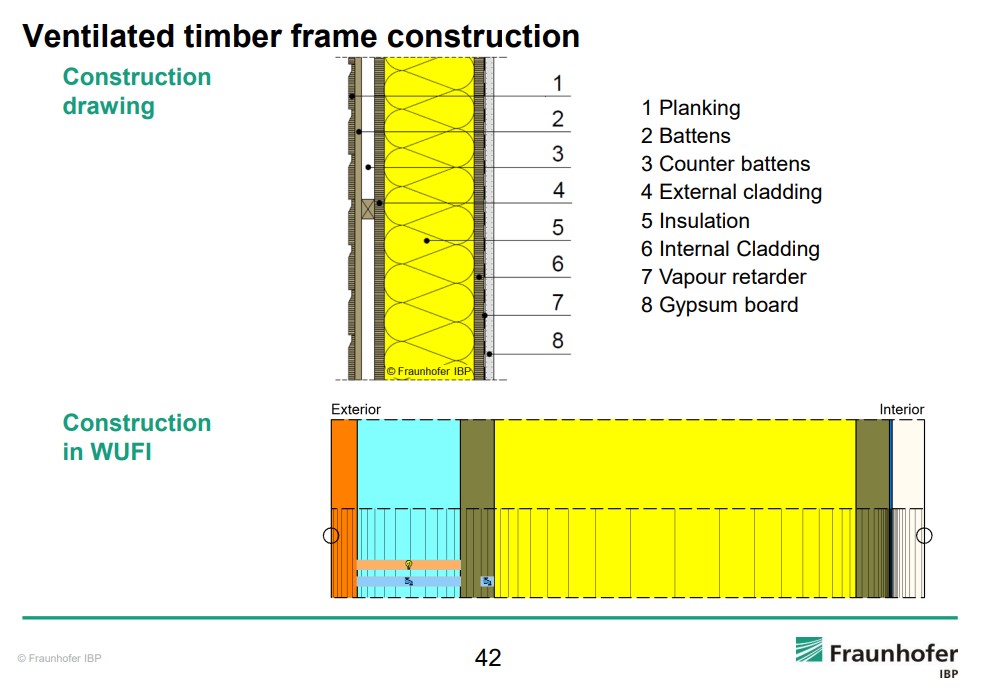

From the guideline of typical construction that is in the website. i have see this ventilated timber frame construction
Screenshot 2022-04-26 134606.jpg (98.34 KiB) Viewed 67644 times
. it is mentioned to add a 1 % rain but it is not indicated where. where should it be placed? could you indicate in the drawing for a better comprehension please

Generally spoken a source has to be included at the position, where the temperature or moisture will appear or in this case where rain water could be run in. So just image where water, which may run in eg. at a window sill will flow.
The German Standard DIN 4108-3 Annex D writes the following:
  • 1 % of the driving rain hitting the component surface should be added as moisture source in the substructure.
  • It shall be applied to the outside 5 mm of the moisture-sensitive substructure (for thinner layers: entire material layer).
  • If this first layer of the substructure is a foil/underlay, no moisture source is to be applied
In the case of the USA example, if you would place the source on the inner surface of the brick it is still in the external facing and will probably transported to the outside quite fast. Here it will have about no harming influence on the wooden construction. Thats the reason, why it is placed behind the building paper. This way you can check if the construction is able to handle the extra moisture load.

Re: Air ventilated cavities and air unventilated cavities
with substructure the load bearing construction is meant. So the structure below the outer finish (eg. cladding).
The rain source should be placed at the position, where intruding rain water can run in. The intrusion may happen for example at the connection of the window sill to the wall. Philipp suggested the 1% driving rain behind the first layer, and so placed it in the air gap. Instead of placing the rain source in an air gap, where intruding water could run down directly, I would place it more in the bricks itself, where the water can be distributed due to the capillarity. You also can place it in the insulation behind the air gap, if you assume, the intruding rain water may come up to there.
