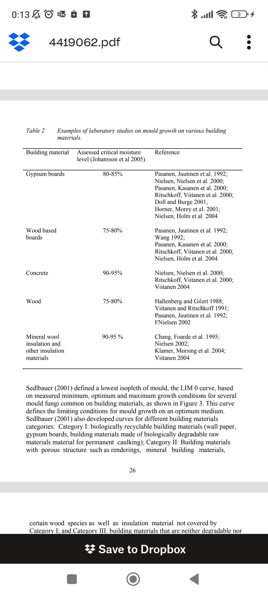

Normally it is said the typical threshold value of 80% but reading on internet it is said 90-95% as you see in the screenshot.
That does not apply here, as there is no big risk of mould growth in the mineral wool itself - the table says: "on the material", not inside - so if you evaluate centimeters? you will get a completely different mean value. If you like to evaluate according to this table you have to assess the outermost element of the calculation grid of the mineral wool - not centimeters. Our mould model (WUFI Bio) is validated mainly for the interior surface and can be used on the warm side in the construction but with care. We do not recommend to evaluate the mold on the cold side in the construction.

But I don't understand the first part of the comment after
1- "Normally it is said the typical threshold value of 80% but reading on internet it is said 90-95% as you see in the screenshot"
Could you put an example please about what you mean to analyse the in the mineral wool?
Or do you mean that the only way to assess risk mould growth or water run off on mineral wool is analysing the last rectangle/ bar grid by WRB for relative humidity (90-95% limit) and using 1cm thick ( outermost centimetre ) procedure ( link you sent me) when we use the water content ( instead of relative humidity) as variable to analyse the mineral wool ?
The table you are showing says in the header "...studies on mould growth ON building materials". If you evaluate centimeters of mineral wool as you mentioned, the water content you are assessing is inside the mineral wool, not on the surface.
Yes, exactly, outermost element of mineral wool or also WRB for relative humidity.
