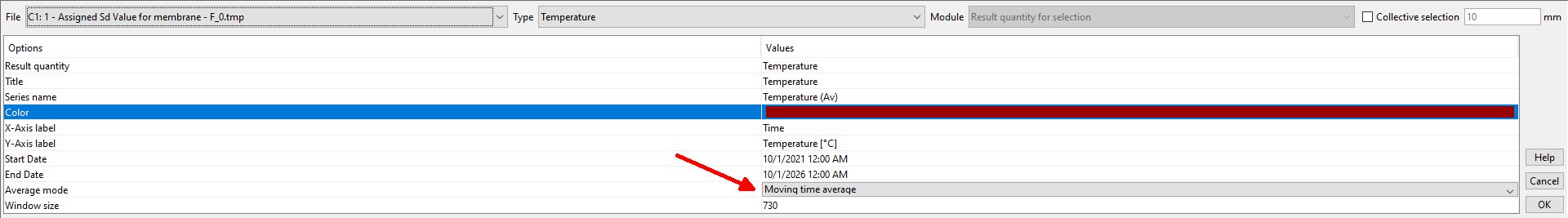

here you can find a explanation of the moving average:
https://en.wikipedia.org/wiki/Moving_average
You can create courses in WUFIGraph:

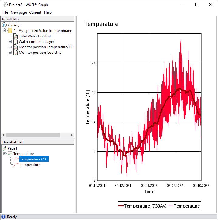

The window size is related to the time step. In this case the results contain hourly values, so 730 hours corresponds to one month => Monthly average.
This is how it looks result:
