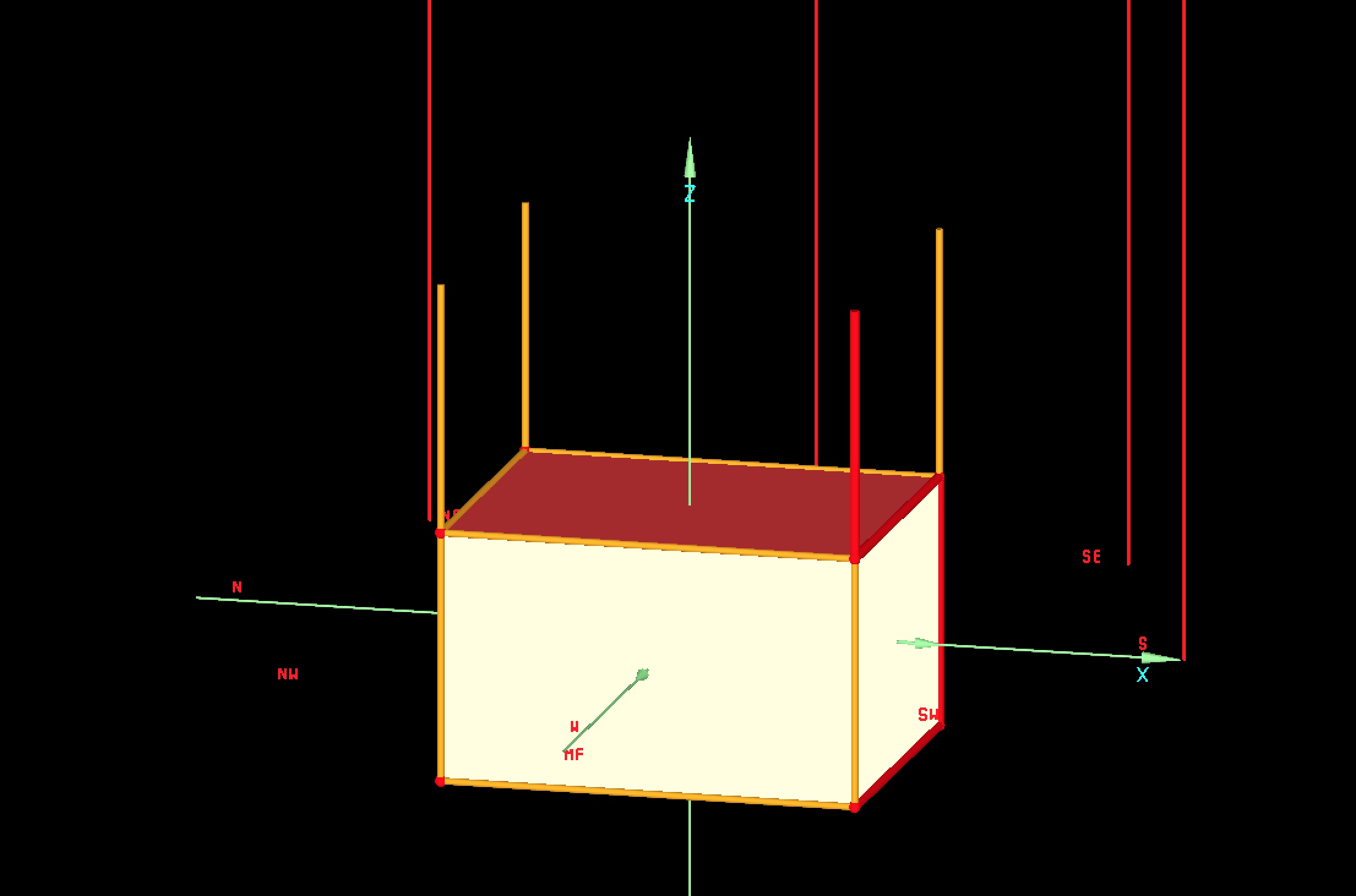

unfortunately the display of the 3D building somehow is wrong, as seen in the attached picture. The walls of the building aren't properly displayed as well as the orientation. I wonder if this is a problem caused by a wrong installation of the program or a problem that is caused by a wrong setting. I use the Version WUFI Plus 3.2.0.1.

Display of the 3D building in WUFI Plus
- Screenshot of the problem
- Screenshot WUFI Plus.jpg (139.6 KiB) Viewed 53302 times

Hello Martha,
Thanks for your post. This visualization bug is related to some latest graphic card updates. It does not influence the simulation itself. We are working on it.
The only known workaround, at the moment, is to roll back the last grapic driver update, or install an earlier version.
Matthias
