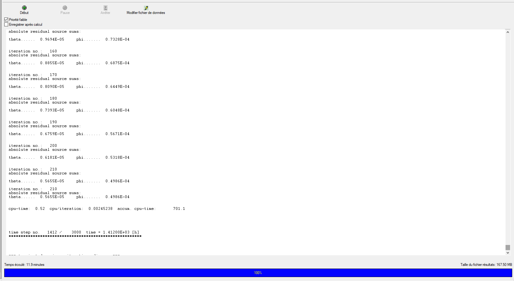

I launched a calculation several times. And each times, the calculation stopped at the same time step : number 1412.
I don't understand why. I don't see any error message. It's probably a current error but I don't find it.
You can see a screenshot in attachment.
I have not idea about some thing to change to correct it. Perhaps in enhanced parameters but I don't know which parameter ...
Could you please help me ?
Thank you in advance

Dear Benoit,
the last line of the iter.txt was cut off for some reason. If you open it up in an editor you can see it:
There were some problems in solving the systems.
Please try to use a finer grid and try to replace the material data of the Douglas with another wood material, as there are quite high moistures are forming there.
Code: Select all
time step no. 1412 / 26280 time = 1.41200E+03 [h]
*** terminated -- inner iterations diverge ***
