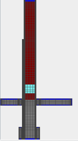

If I have a construction like this:

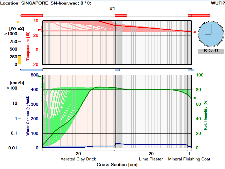

Selected area for graph 1.PNG (9.7 KiB) Viewed 23373 times
and I would like to visualise the water content of the selected area in the graph, Iis it able to output a graph similar in WUFI 6:
WUFI graph.PNG (76.83 KiB) Viewed 23373 times
, where the water content can be visualised across the different layers at a specific time.

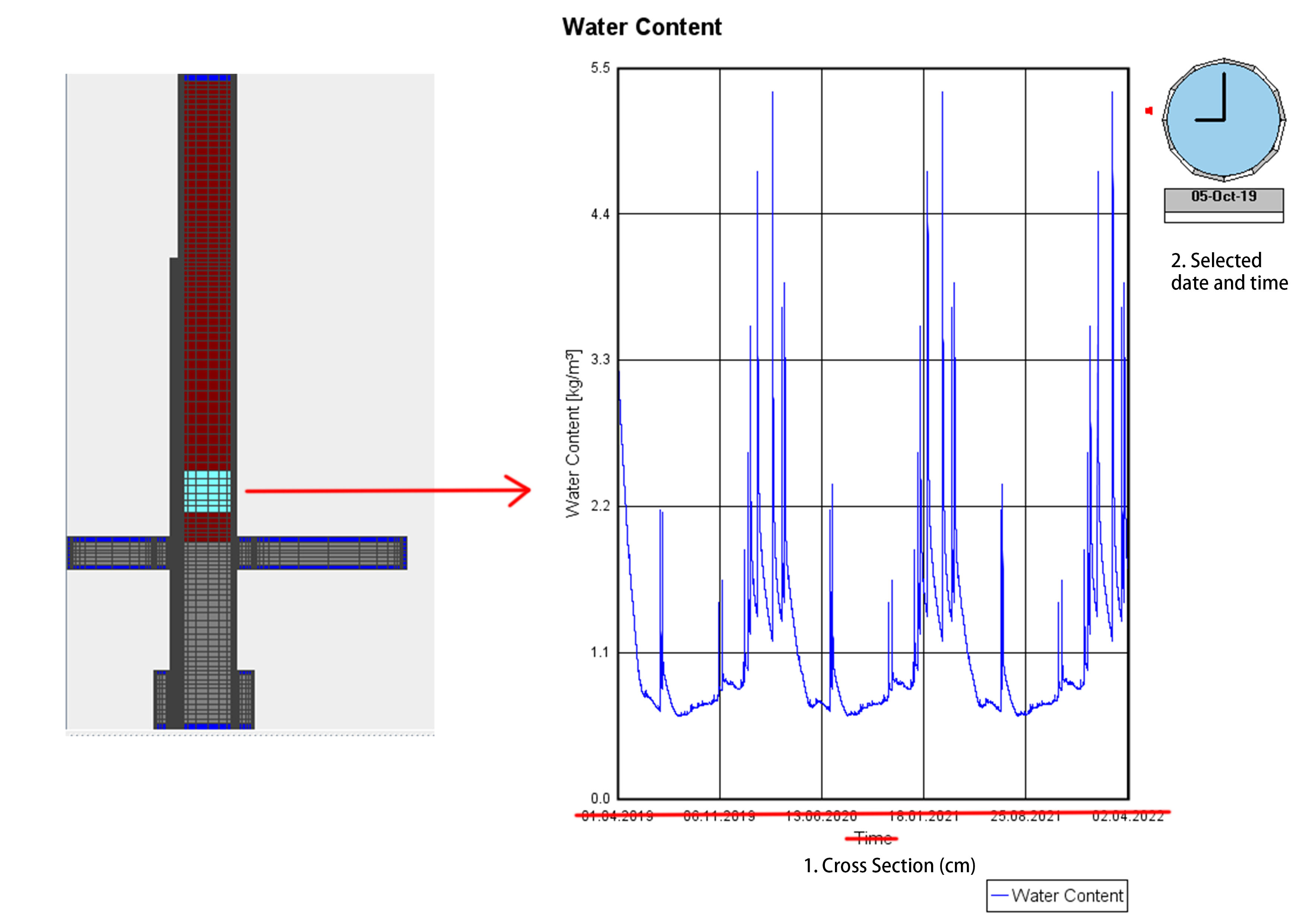

If not, could I achieve an output similar to that of :
wufi graph 2.jpg (550.95 KiB) Viewed 23373 times
Re: Wufi Graphs - temperature/distance
Posted: Mon May 20, 2019 8:25 pm -1100
Hi Annie,
yes, that is possible.
Select the type user-defined an there the module: Profile along cross section.
See the WUFI Graph help for more information.

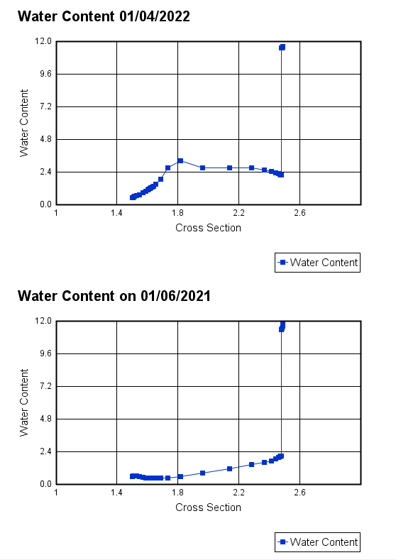

Thank you for the prompt reply, I have successfully created the profile graph.
Water content profile.png (20.21 KiB) Viewed 23368 times

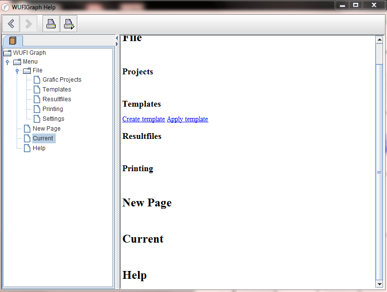

However, I am unable to access the Wufi Graph Help on the software. Is there a web version that I can download? I have tried finding on the website but was unable to find it.
wufi graph help.PNG (58.31 KiB) Viewed 23368 times
Thank you very much,
Annie Wu
Posted: Tue May 21, 2019 12:10 am -1100
Which version of WUFI Graph do you use?
With the newer versions there is a pdf-help usually here:
c:\Program Files (x86)\WUFI\Tools\WUFIGraph\help\WUFIGraph_en.pdf
