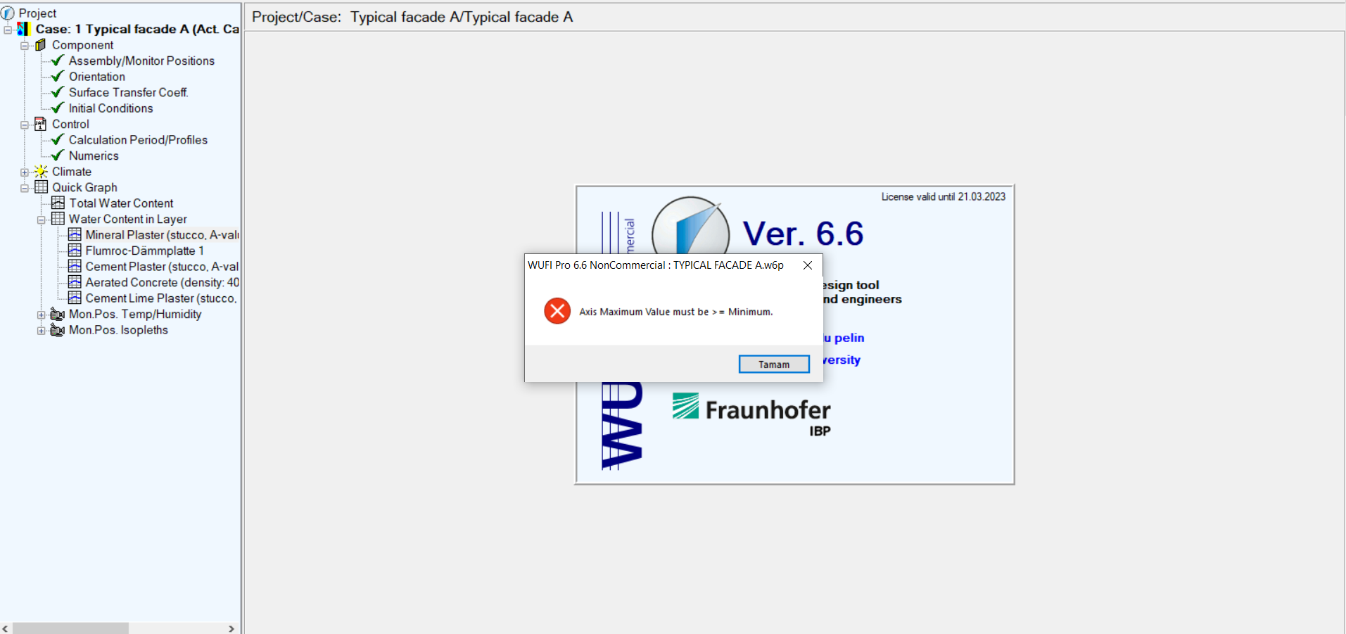

Hello everyone,
When i finished my calculation and can not see the graph results because of this warning;
What is the problem ? i don't understand please reply me ?
Thank you.
Re: Convergence Failures
Posted: Wed Oct 26, 2022 11:59 pm -1100
please check if there are values in the table "Status of Last Calculation". If all fields are filled with "NaN", something went wrong with your calcualtion and there are no results to show.
Posted: Sat Dec 03, 2022 7:12 am -1100
by saricioglu pelin
Thank you Christian. It is solved.
