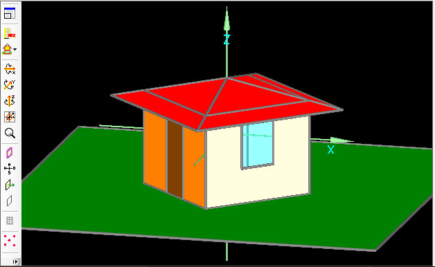

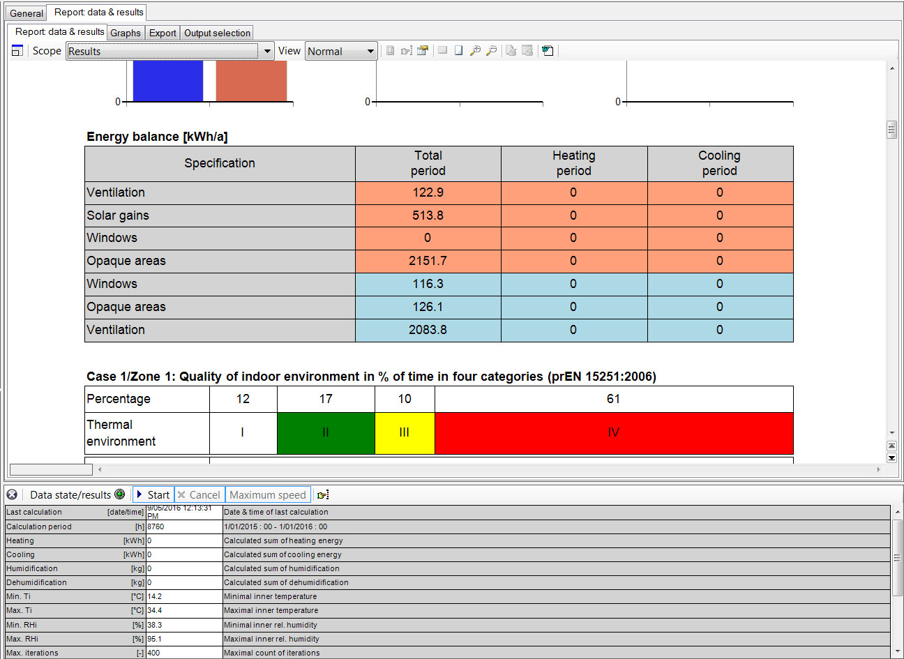

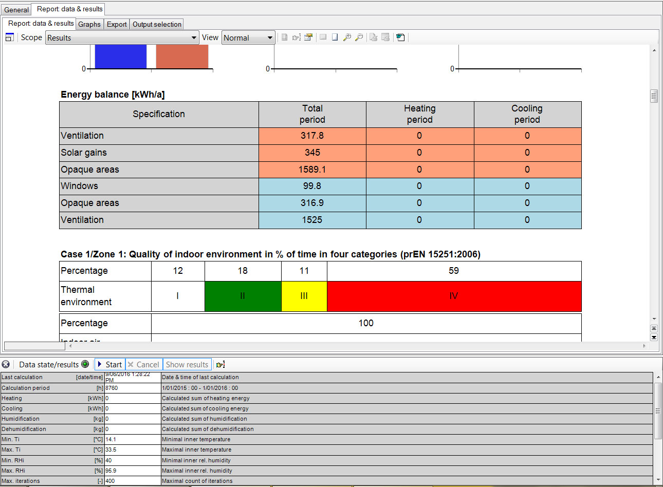

I am comparing different cases of a simple building model (in 6 different locations and 4 rainfall modes). A month ago I made a final run for each individual case (24 in total) after I revised very well all inputs. In the month that has passed I exported and organized all the data from results. Today I decided to add another case to every location but I obtain results which do not correspond with the originals of the last month (see images attached). I am using the same original files and made no change.
The problem is related to "Include shading calculation''. If I unselect this option in "Building/numerics" the results are the same as the originals. However, I had this option activated (in "Preprocess" mode) when I ran the model a month ago. The "new" results (with lower heat gains) make more sense with the shading that the roof eaves provide. But now I don't trust any results and I need to confirm which are correct.
I suspect this issue is connected to the WUFI Plus version. I changed computer just after I finished the final run, and I moved from version 3.0.0 to 3.0.3.

Hi catodiaz,
you've suspected this correctly: In WUFI Plus 3.0.0 was a bug, where shading results calculated as "preprocess" were partly not considered in the simulation. This problem was fixed with the first update 3.0.1. From version 3.0.1 or above, shading calculation gives the identical results in both calculation modes "preprocess" and "every timestep". So, the simulation results with the newer version 3.0.3 are the correct ones.
