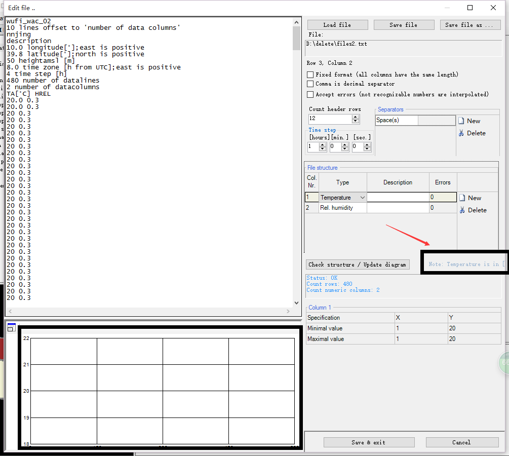

1, when i manually input the data in the blank, the temp column have some error showing in the status tips.but i can't wholely read the tips .

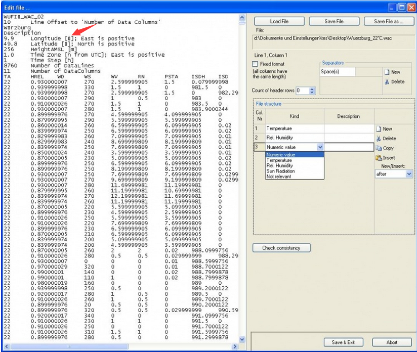

2,the unit of latitude and longitude [°] .i am confused what its format is. i just text it in word and change the format to TimesNewRoman. it seems different from the example on wufi-wiki as below.

1. ok, the marked note is to long for your windows-default-font. It just says: " Note: Temperature is in [°C]" in degree Celcius. This is not an error. the box below is relevant for errors and it says: Status: Ok. so everything seams to be fine. your file has only one themperature. 20°C, so the graph isn't drawn perfect, behind the grid in the graph. But if you have an look at the minimal, maximal value, both is 20°C (in the y-axis).
2. the named unit for latitude and longitude is just informative. It's degree, so the Latitude is defined 0° (or 0 degree) from equator, to 90° north or -90° south. the longitude defined from 0° greenwich to 180° east and -180° west.
