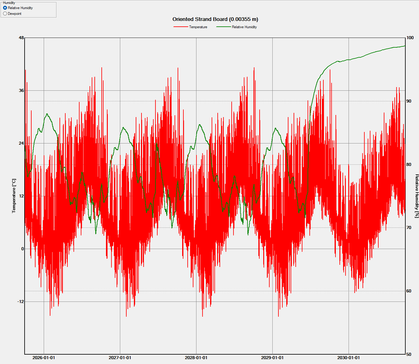

I am conducting a simulation in WUFI Pro 6.5 on a light wood frame wall assembly with a 20 mm ventilated drainage cavity (with a ventilation rate of 10 ACH). The siding of the wall is 10 mm LP SmartSide Siding. There is a moisture source of 2% of the wind-driven rain leakage into the assembly. I have modelled the moisture source to be applied on the right-hand side of the cladding (on the inner 7 mm of the cladding).

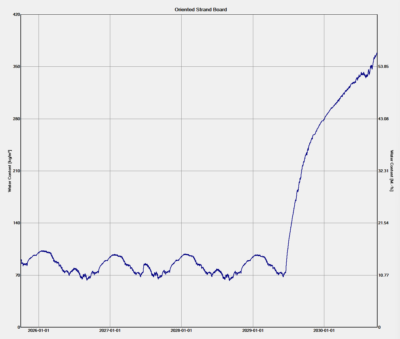

The moisture imbalance in the simulation is 14.93 (balance 1 = 5.94; balance 2 = 2 -8.99). I ran the simulation for 5 years. During the first three and a half years of the simulation, the results seem to be "normal" compared to similar simulations. Over the last 1.5 years of simulation, the relative humidity in the sheathing layer increases to 95-100%, whereas in the previous 3.5 years, it ranged between 65-85% in the sheathing layer. As a result, the water content of the OSB sheathing, the air barrier and the air layer sharply spikes, to (seemingly to me) unrealistically high numbers (air content water content gets up to 200 kg/m^3, OSB jumps from 10-15% moisture content in the first 3.5 years up to ~50% moisture content in the last year of the simulation.
Note, the climate file is from St. John's, Newfoundland, in Canada. I modelled the same wall assembly with a moisture source of only 1% wind-driven rain leakage, and the moisture balances were even, and the moisture content of the sheathing stayed between 9 and 14% moisture content.

Please let me know if there is any additional information I can provide to help in answering these questions. I have attached a screenshot of the OSB sheathing water content and a screenshot of the relative humidity and temperature at a layer within the OSB sheathing.

Hi Ben,
that is probably related to a convergence problem, which is also shown by the differences in the balances. After five years there is probably dew water forming or supersaturation reached somewhere in the construction (see film), what causes problems in the solving process.
We do not recommend to evaluate the results, if there are significant balance differences.
Please try to activate the adaptive time step control in the control -> numerics branch.
If that then still appears, please check, if you have condensation in the air layer. If yes, you might try to split that according to:
viewtopic.php?f=32&t=1777&p=5226#p5226
