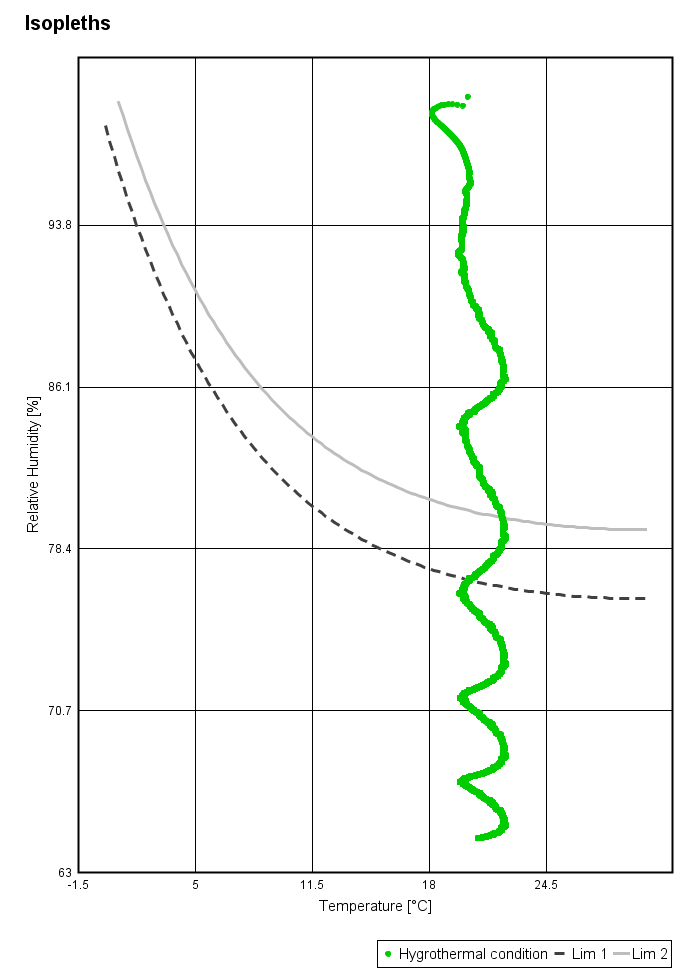

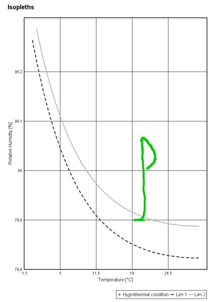

I have made a simulation model for one year and five years to make a comparison. I have 2 questions:
1) I can see that, after 5years, the humidity is quite lower, lower than 80%. But there is still green points above the LIM curve, are these points the results for the first year simulation? Or does it mean there is still problem with the low humidity?

isopleth of the mold growth prediction
- one year isopleth
- one year isopleth.jpg (127.36 KiB) Viewed 7952 times
- five years isopleth
- five years isopleth.jpg (148.34 KiB) Viewed 7952 times
Re: isopleth of the mold growth prediction
Hello yang,
1)
there is one dot printed for every hour, so maybe the top dots are the dots at the startign conditions, then it is drying out and the dots are is going down. Or the other way around. Please update your WUFI2D, as there is a new version of WUFIGraph 2.5.0, where you can see the plot direction of this curves. I send you a PM.
