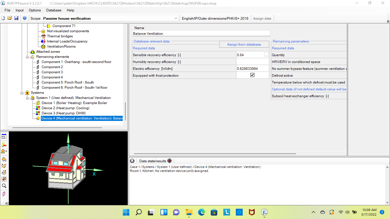

I have received the error message "No Ventilation Device (unit) assigned". Enclosed is a screen shot of the message and its 'solution' location where I was directed when I double-clicked the error message.
I was expecting to see a list of rooms on this page to which I could assign a ventilation device.
Is there another location where this link can be made?

If you click on the Ventilation device in your Systems, you'll see a line that says Rooms ventilated by this unit on the bottom left of the pane on the right. You need to scroll through the list (which, for some annoying reason, only shows one room at a time) and find the room you're getting the error message for and click the box so that WUFI knows your Ventilation Device is dealing with this room.
For some reason, if you have the Data State open on the bottom right of your screen, this part of the tab disappears. WUFI designers take note!
