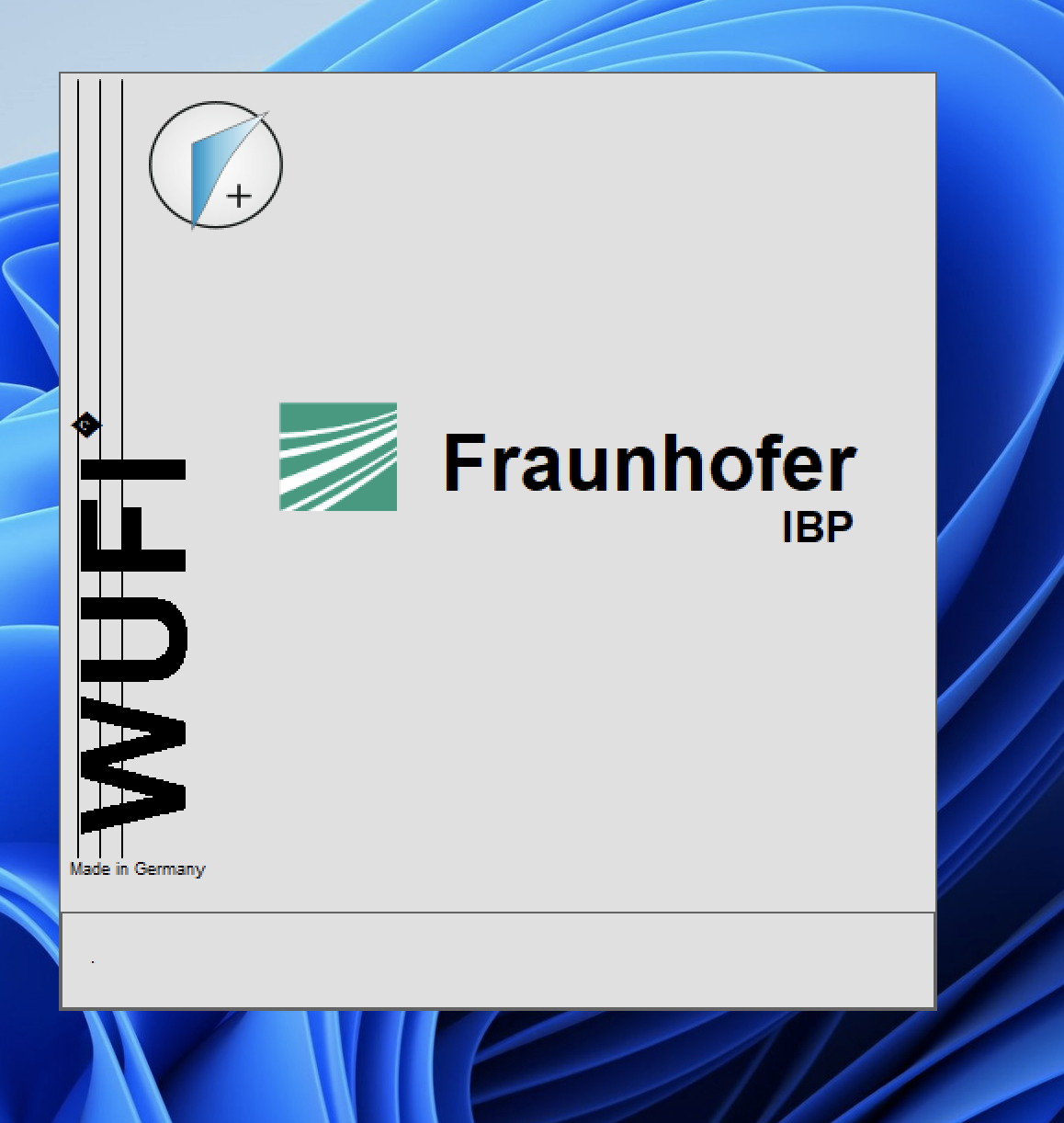

So I've just created a new, fresh virtual machine in parallels and installed WUFI Passive. However WUFI does not start as expected. When attempting to run WUFI a loading screens for WUFI appears for a few seconds then closes and the program does not start. See attached screenshot of that startup window.
I had been using WUFI Passive in Parallels on a Windows 10 virtual machine for years with few problems so I have no idea what the cause of this might be.
Any ideas on what I can do to get WUFI to run?
